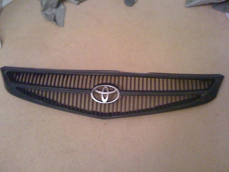

Alright finally, after many hours and messages back and worth, I took off the grille. Nobody freaking told me that I am supposed to pull it towards me. I though that I was supposed to pull it up lol.
So this is how it looked before sanding.
Now I sanded it down with 360 I think.
[Image

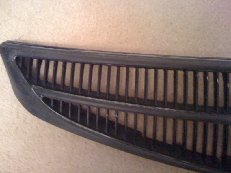

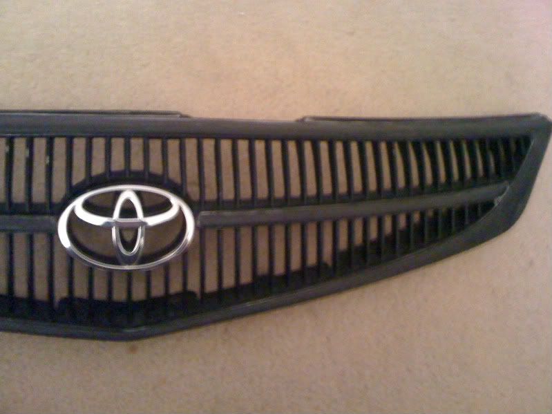

I screwed up and sanded the bars by accident. crap, lol any suggestions how to fix them?
I am using the primer before sanding it again and painting. I am using standard spray paint. Could you give me any warnings about the spray paint? I have never used it before lol.
So what do you guys think?

Postby .onetohate » Sat Feb 27, 2010 9:24 am
360 grit is a tad aggressive isn't it? because it would show the direction/cuts through the paint. So with that said, grab a can of FILLER primer.
2nd. is the grill plastic? .. if it is- use something like Krylon Fusion for plastic since that's what a lot of board members use for interior plastic pieces plus i don't really know what "regular spray paint" entails? .. LOL.
3rd. get a small pack of 1000 grit sand paper for more sanding..
4th. Remember, prep is everything!.. poor prep and it'll be a poor paint job.
so go..
1. Wipe down
2. Primer
-- dry --
3. Wipe down
4. Primer
-- dry --
5. Sand (1000)
6. Wipe Down
7. LIGHT COAT: LIGHT EVEN COAT so it sticks to the primer while it dries.
-- dry --
8. LIGHT COAT: I CANNOT STESS THIS ENOUGH
9. Sand (1000): Make sure you get the major corners because that's where prep is overlooked and adhesion could be a problem.
10. Wipe Down
11. Spray away!

Postby loveImports » Wed Mar 03, 2010 4:58 pm
Hey quick question, I sanded the bars on my grille by accident.
Do you guys think I should sand down the bars compelty then? Or is there any way to fix the scuffs on the bars?
I am painting the grille all black.

Postby kenny6683 » Wed Mar 03, 2010 5:18 pm
just sand the bars like the rest of the grill...prime it and just take your time between coats...give it 20 minutes dry time instead of 5. This is to make sure you dont get wrinkle or cracking paint

Postby loveImports » Wed Mar 03, 2010 5:30 pm
Sorry for my questions, do I also sand down the inner part of the bars, meaning the front and the sides.

Postby loveImports » Thu Mar 04, 2010 3:56 am
PLEASE PLEASE PLEASE PEOPLE
tell me what to do about sanding down the bars. I am about to start painting the grille today and I need advice.
Do I sand them all the way, or just the front?
