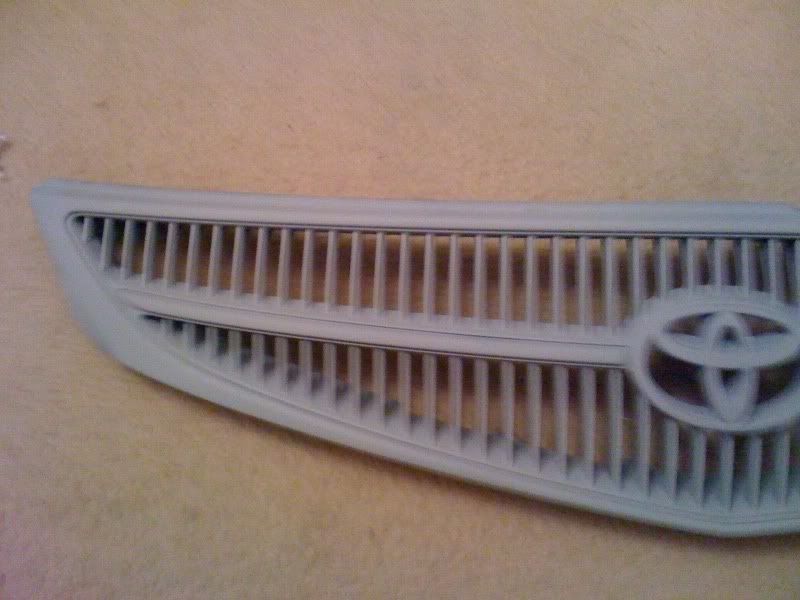

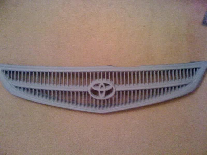

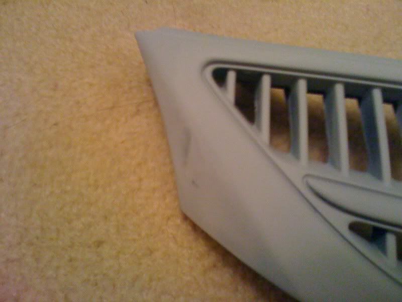

Postby loveImports » Thu Mar 04, 2010 9:36 pm
Alright, after 3 hours of sanding the bars down, and 30 minutes after using 320 to smooth things over. I washed it twice with dish washing soap.
I dried it and primed it.
3 coats total, I did everything what you guys told me. After priming everything it was 7 oclock, it got too dark to sand it again and paint it.So I am going to postpone it again because it's going to be fcking raining again in the Bay tomorrow.
Here are some photos
It has some smudges, scratches, drips and bumps, but sanding will hopefully take care of it.
Btw guys, any tips about sanding it after the primer?

Postby Ruski » Thu Mar 04, 2010 9:54 pm
Sanding after priming should be a light pass, just enough to get rid of the imperfections. use a smooth grit
Postby loveImports » Thu Mar 04, 2010 10:04 pm
I am using 600 grit to take care of it.
THANKS, Ruski

Postby .onetohate » Fri Mar 05, 2010 12:05 am
600's too rough- .. lol! 800/1000 should be good.

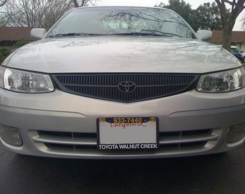

Postby loveImports » Fri Mar 05, 2010 6:17 pm
After so much time, hard work, and few bucks,I finished it.
THANK YOU EVERYONE! I wouldn't be able to do it without you or my friend that helped me with the primer.
It ain't perfect, but it's perfect for me
There are some leaks and smudges, and I touched the wet paint with my finger and took off some primer off it too. But I LOVE IT. THANKS AGAIN
