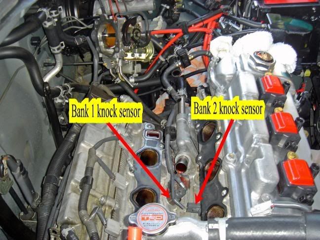

Postby siennasc98 » Sat Dec 23, 2006 12:20 pm
jalen wrote:To add more:
The engine check light is on when I test drive the car. And the dealer said it is a O2 sensor issue and he will replace that later.
Please comment
Did they tell you the OBDII error code? If it's P0325 or P0330 then it has a bad knock sensor(s). The sensors are about $150/each but very... very... very painfull to replace since they are underneath the intake assembly.
