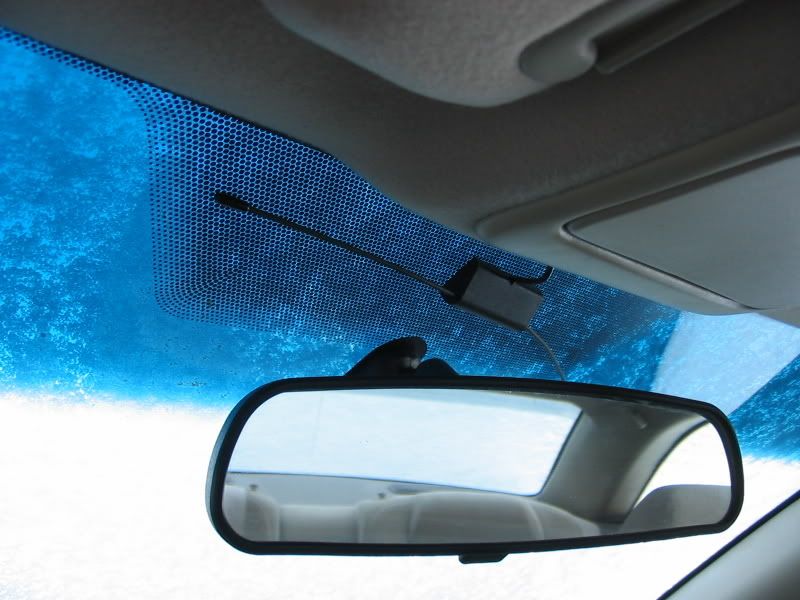

Hi Guys,
I tried the search, but didn't find any information on what I was looking for. I have a '99 SE V6 5spd for reference.
I have a keyless entry antenna located below my rear view mirror, and I was wondering if this is the stock one (does it look like your stock one)? I'm certain my car doesn't have the factory alarm/keyless system, because my car works fine with just the metal keys (no resistor in the key). My main question is: were solara's that didn't come with the factory alarm/keyless system still equipped with the antenna, or is this some aftermarket one put on by the previous owner?
I've attached the following picture so you can see what it looks like:
(that's snow on my windshild BTW, not dirt :D )

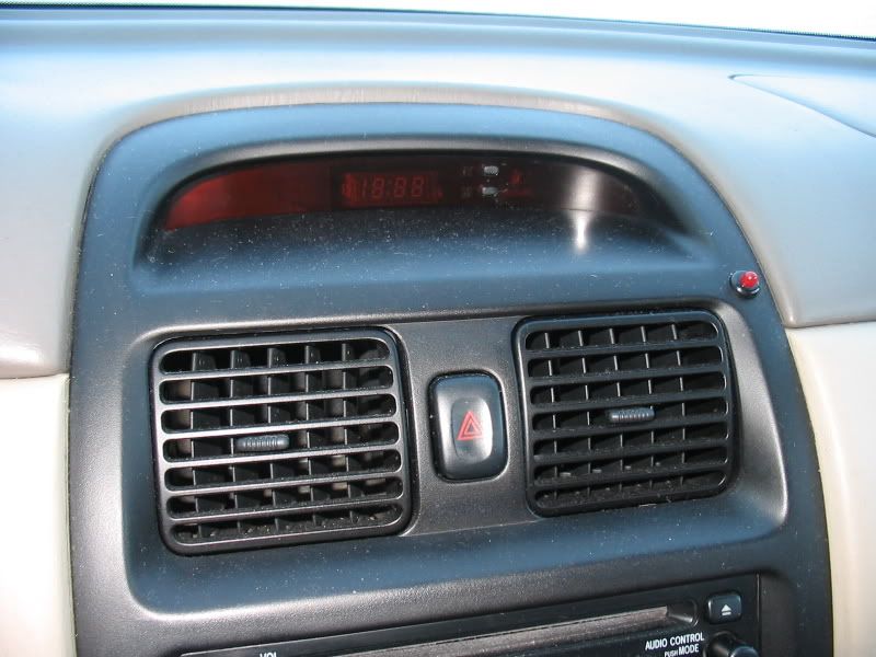

Another thing that led me to believe that this may be an aftermarket system is that there is a red LED on my centre console, but not down by the DC power outlet like some other threads on here have said it would be located. It doesn't blink or anything, so I don't even know if it's even real, or some fake one that people put on to scare theives away.
This picture shows where mine is located:
Excuse the dust, I haven't cleaned it in a while (damn winter!)
So, with that in mind, if this is an aftermarket system, how would I go about finding out what kind of system it is? Is there a typical place where people install the actual system that I could look to find out? (forgive my ignorance on this, I don't know what's needed to install a security system). When I bought the car, the dealer didn't have any FOB's or didn't say the car had any sort of keyless/security system.
Thanks for any help you guys can offer, this site has been a great resource of helpful information

aftermarket
the actual security system is probably on the drivers side, deep behind the steering wheel. You can usually get to it by removing the kick panel and fishing your hand all the way up.
I thought all solara came with transponder keys and keyless remotes.

That is definately an aftermarket alarm and keyless entry. Maybe if your lucky, even remote start!

This is something you're gonna have to take to a car alarm place to figure out, unless you want to find out on your own. anttarz is right about the location of the alarm module. That is where it usually is, down below near your left knee. You're gonna have to remove the kick panel and then look for the module. Once you find the module, of course, the brand/make/model will all be on there. From there, you can go back online, and find resources relating to what you need. You'll find if you can get any accessories, extra remotes, etc... for it. If you take it to a car alarm place, bargain with them or something, they can probably tell you what you have when they look though. Like, literally, it'll only probably take them 2-3 minutes to tell you once they get in, cuz they know what they're doing already. Shouldn't cost you anything if they're friendly people wanting to help. Good luck! and welcome to SG

Yeah, that's aftermarket... I have the SLE (luxury edition) and it doesn't have the antenna or the LED there... The factory one for my car has a red LED built into the instrument panel next to some white text that says "SECURITY" in white lettering.

the thingie by the front windshield, we all got it (all solara's have it).
the light, like others indicated...

Jai_Jai_Binks wrote:the thingie by the front windshield, we all got it (all solara's have it).
I don't. The most I have is a covered wire running straight up and down... But then again that's for my electrochromic mirror, but definitely NOT an antenna.
