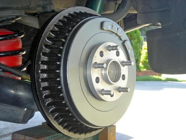

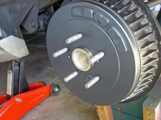

If the traditional mallet trick does not work, the drum (bore) is now stucked with the hub due to rust. Then used those two small holes (8mm 1.25 pitch thread) to disengage the drum out of the hub by inserting bolts and alternately (1/2 turn) tighten the bolts.
Image Image
The 15mm H&R wheel spacer and longer studs installed.
The van looks like it was dropped with the aid of the spacers and taller tires (235/55R17).
