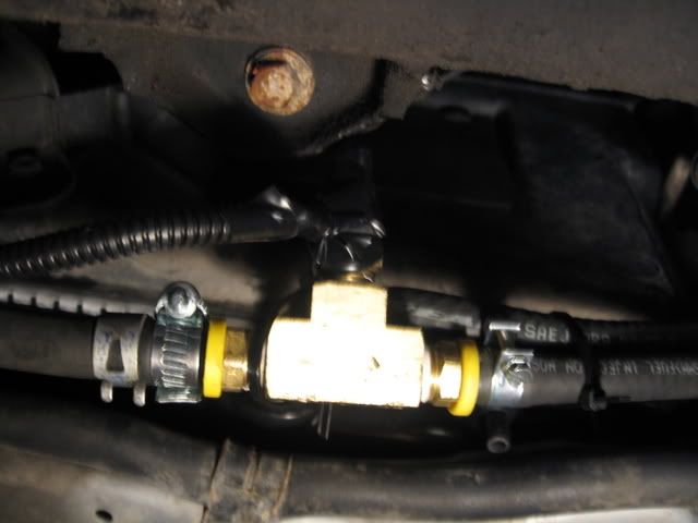

to install a gauge, the hardest part is just running the signal wire into your car. to install the sensor itself, you'll need some fittings to fit into your rubber lines (it's the same thing for the in/out lines, depending on what you want to read- you can do both to get a pre-cool temp and a post-cool temp) and then the sensor that is supplied with the gauge will fit into the fittings. you will then just need to run a signal line inside your car and a ground line to a ground on your car by the sender unit.
here are some pics to get a visual on it
you can see the fittings and sender unit attached to the hose hanging behind the cooler
And here's a close up
