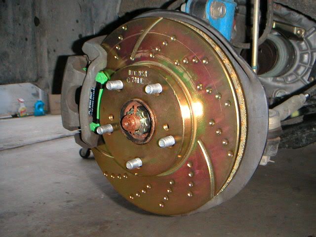

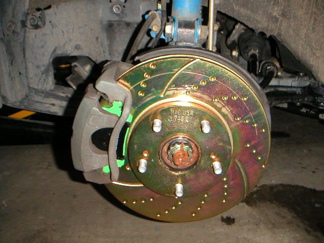

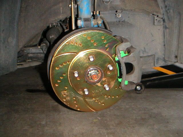

Postby Elfumador » Fri Apr 28, 2006 7:59 pm
Just installed it today, they are going get the rear ones in stock next week, but I just wanted to shows some pics of the front :D

Postby krook » Tue May 02, 2006 12:41 pm
i'm pretty sure you have the rotor on the OPPOSITE side of the car. switch your driver's side and passenger's side rotor.
crossdrilled rotors are directional, meaning that the way the line rotates should be the same as your tires.
sorry to say; SWITCH 'em up.
krook
Posts: 2673
Location: Hawaii
Postby SleeperSolara » Tue May 02, 2006 2:11 pm
krook wrote:i'm pretty sure you have the rotor on the OPPOSITE side of the car. switch your driver's side and passenger's side rotor.

Postby hskrsolara » Tue May 02, 2006 3:16 pm
Actually i think his rotors are in the right driection.
I made the same mistake the first time I put on my drilled rotors. Krook is correct, the rotors DO need to be switched.

Postby GReddySetGO » Tue May 02, 2006 3:21 pm
Which one is the drivers side and which one is the passenger side? I think they are on correctly...

Postby hskrsolara » Tue May 02, 2006 3:31 pm
looks like the top is the driver's side.

Postby GReddySetGO » Tue May 02, 2006 3:59 pm
If the top 2 are driver's side and the bottom is passenger side, then yes it might be backwards. Double check the instructions or look on the rotor themselves. Its usually stamped with the direction its supposed to turn. All the slotted rotors I can remember installing are opposite of what is pictured here. You want the slots to go into the pads, not with it.

Postby GReddySetGO » Tue May 02, 2006 4:01 pm
Oh, and from looking at the pics again, I hope you were using jack stands, not just that jack in the front :p

Postby krook » Tue May 02, 2006 4:41 pm
the direction of the slots and holes (direction starting from the lug nuts to the outer edge of the rotor) should be going TOWARD your caliper if it's the front rotors and AWAY from your caliper for the rears.

Postby SleeperSolara » Tue May 02, 2006 6:30 pm
Well in some pictures i see the slots slanted straight like "Elfumador" but straight......
