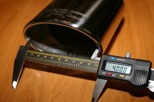

I might recommend using dual wall tips. Yours are single wall. Dual wall has a lower skin temp and can be installed a lot closer to the body kit than a single wall.
Here is a set I have waiting for the next custom exhaust project. It has perforations on the innerpipe and glasswool insulation between the inner layer and outer.
