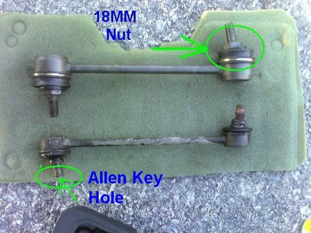

Postby unbalancedwood » Mon Oct 22, 2007 6:22 am
Hes talking about the sway bar links. your gonna need new ones (advanced auto has them for $50) I had to do the same thing for one of mine. sucked.
Top: aftermarket
Bottom: stock
but for this aftermarket one I had to make a tool to hold the wrench part behind the sway bar/strut, it does not use the same allen wrench setup. See you cant exactly get a full size wrench behind them and tighen all the way. I fashioned this thin wrench tool.

Postby woa_its_j3ff » Mon Oct 22, 2007 6:33 am
unbalancedwood wrote:Hes talking about the sway bar links. your gonna need new ones (advanced auto has them for $50) I had to do the same thing for one of mine. sucked.
Top: aftermarket
Bottom: stock
i dont think thats the right part. there is a spot for the allen wrench key..
Postby woa_its_j3ff » Mon Oct 22, 2007 6:40 am
for that thin wrench.. where did u get it? i tried using vice grips but it wouldnt fit, it was too big so...
and pliers of course didnt help
Postby CamryOnBronze » Mon Oct 22, 2007 6:51 am
the endlinks do have a spot for the allen key- look again, that is the only thing on this install that could possibly have an allen key... I just removed my suspension like two weeks ago and that is the only part that requires an allen... you wont be able to get a new nut and bolt, youre going to need new endlinks most likely... the bolt in the endlink cannot be removed from the link, so if it is damaged you will need new ones.

So Damon you are saying if I cut it I'll have to get a new sway bar link?..
it cant be removed? I thought we removed a bolt from the passenger side (the one we got in the aftermarket struts n springs).[not the bolt by the calipers, but on the strut]
Postby CamryOnBronze » Mon Oct 22, 2007 7:16 am
if it is the actual endlink, there isnt a bolt that comes out- it has a boot over it and pivots on the endlink, so it doesnt come out... get us a pic if you get a chance but Im pretty sure youre thinking of the endlinks...

Postby Midias » Mon Oct 22, 2007 2:55 pm
Top: aftermarket
Bottom: stock
I used the same ones and use a 18mm wrench ground thinner on a bench grinder. Mine stripped out so I used a cut off wheel on my angle grinder to remove the old.
Postby unbalancedwood » Mon Oct 22, 2007 4:24 pm
yup, its all the same, I guess somthing that theyve probally changed since all these problems with stripping the allen wrench part.
But i doubt Damon gave you his sway bar [end]link. you cant fix it, its screwed, you need a new one, ebay, auto parts online, or your local auto parts store will have it today or next day (45-65$ depending).
cut yours off, get new one, put it on. luckly i screwed mine up while putting it on so i was able to get it off.
All you need to do is put some rubber around it, hold it with pliers, and take the nut off. Be careful not to mess up the threads or you'll have to cut it off with some kind of hand/power saw....
