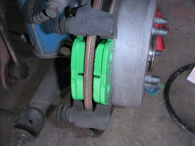

Postby Elfumador » Tue May 02, 2006 7:10 pm
so they're backwards??, If so I'll switch them this Friday.

Postby Elfumador » Tue May 02, 2006 7:11 pm
Top pic is Driver's side

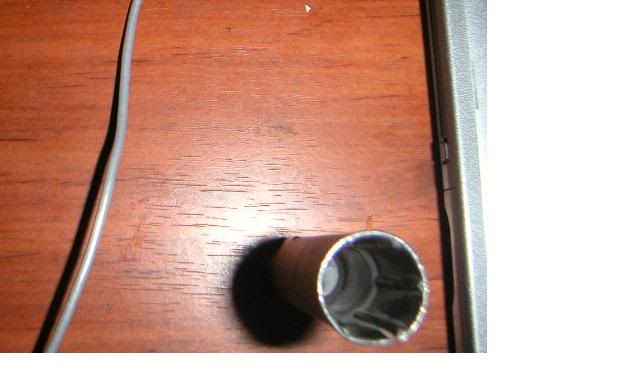

Postby Elfumador » Tue May 02, 2006 7:57 pm
Well I was in the process of switching rotors, but the tham tire shop I went to for the tires used an impact gun to put the Lug nuts back on. I was on the last lug nut when I broke the Gorrilla Lug lock. :x I 'm gonna have to call gorilla tomorrow cause I can't tighten them so the car will stay in the garage till I get a new one.

Postby krook » Tue May 02, 2006 8:18 pm
Elfumador wrote:Top pic is Driver's side
krook wrote:the direction of the slots and holes (direction starting from the lug nuts to the outer edge of the rotor) should be going TOWARD your caliper if it's the front rotors and AWAY from your caliper for the rears.
if the top pic is indeed the front driver's side rotor, it needs to be swapped. you shouldn't have to have removed them and swapped them yourself either if a shop did it for you.
go back to the shop and explain that you attempted to swap it out yourself and in the process broke the gorilla lug lock. have them pay for it, cause damnit i would..!

Postby Elfumador » Wed May 03, 2006 4:16 am
The lug nuts I have all use the gorilla key socket , its a set.

Postby SleeperSolara » Wed May 03, 2006 7:01 am
Man that sucks, yeah did that to a friends' socket; and cracked i in half.
And then when i had a flat and went to get a new tire, the tire shop tightened one of my lug nuts so tight i stripped the lug nut.
And then Walmart stripped 1 of my wheel locks too; they paid for a new set though. :D

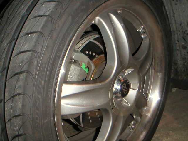

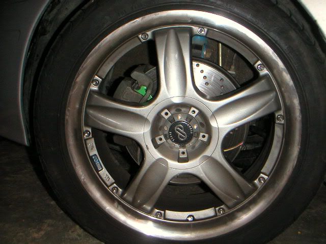

Postby Elfumador » Wed May 03, 2006 6:31 pm
Ok guys here's an update, I had to go to Gorilla to get 2 new sockets, luckly its in Vernon which is about a 20 minute drive, I had to use a torch to heat the lug that was on their tight, but with it being heated up it came off easily. To make sure I don't have this problem again I used some Anti Sieze and torqued them down to the correct specs :D Here's some after pics.

Postby siennasc98 » Wed May 03, 2006 7:27 pm
Sap Z wrote:paint those puppies plz..!
I painted mine in red color.

Postby Elfumador » Wed May 03, 2006 7:39 pm
Looks really nice, when I get some extra time I'll try to do that.

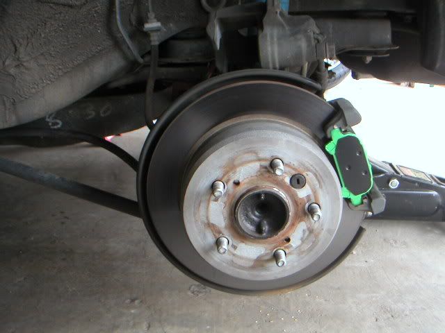

Postby Elfumador » Thu May 04, 2006 8:19 pm
I did the rear brakes today, just the pads and I used a torch on each lug to make it easier to take off :lol:

Postby krook » Thu May 04, 2006 8:58 pm
man....that Greenstuff is really, well.
GREEN. i think i might get the red ones to replace my rear pads since some schmoe sent me the wrong pads off ebay.

Postby 808Camry » Sun May 07, 2006 2:16 am
Yea rotors need to be switched, doesn't really matter but brembo recommends it the otehr way around.
