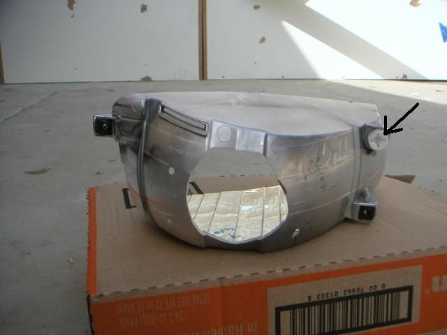

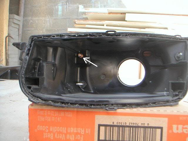

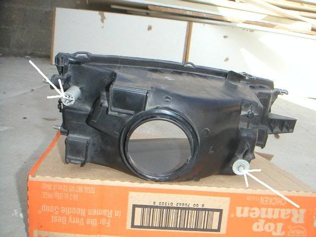

Here's another helpful hint if you want to seperate the the reflector from the housing you will need to knock the plastic cap on the top adjustment screw, then just turn counter clock-wise, after you turn both of the adjument screws, you will need a long Flat-head screwdriver to pop the ball joint out of the socket. Just be carefull you don't want to break anything :lol:

^^^^GOOD HINT :)

Elfumador thanks for that tip. It will come in handy. Your project looks likes its coming along nicely. Keep up the good work. :D
