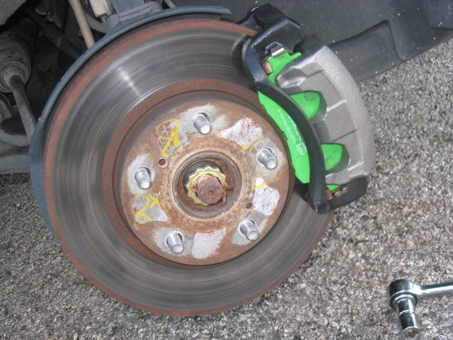

As promised... more pics. I went out today and mocked up my brake set up to make sure everything fit alright with out modification before I went to my friends shop to do the install. Everything fit perfectly. Just like factory. Check it out.

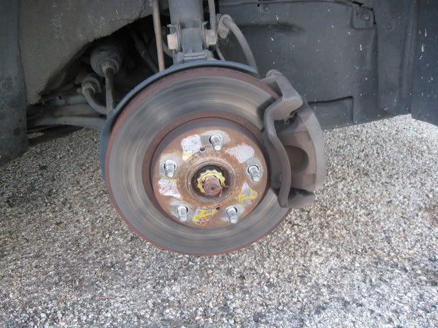

Here is what I started with:

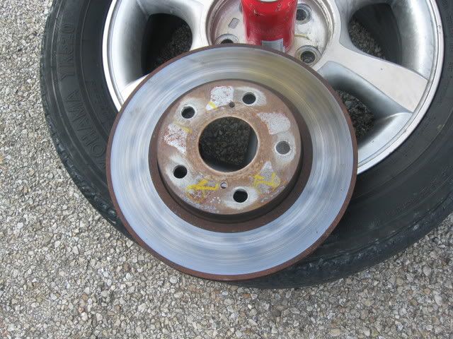

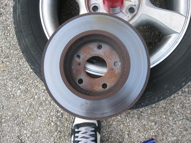

And with my rotor: They looked salvageable to me. Image

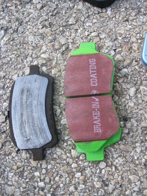

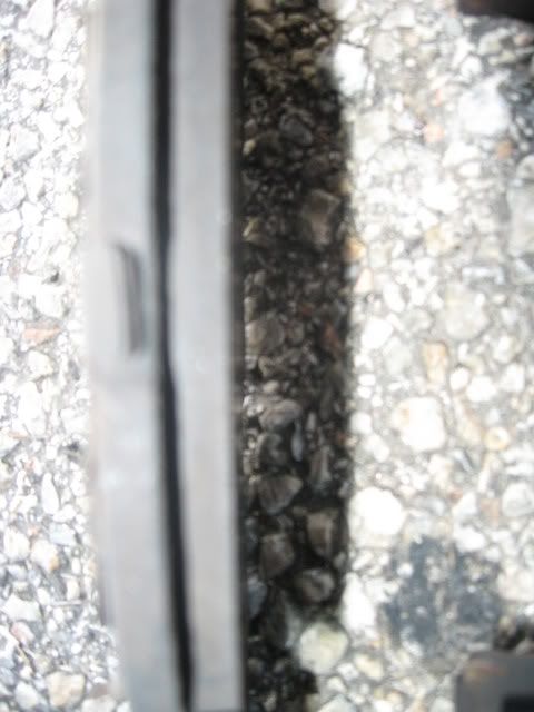

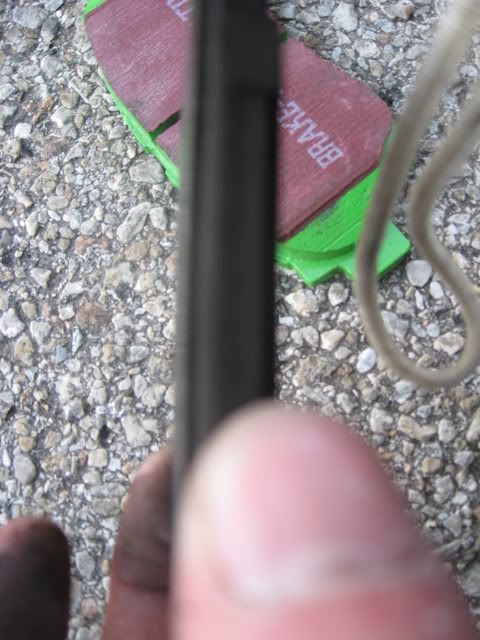

Here is the size difference in pads, one of my old ones was almost completely worn to the metal. LOL
The little lip you see below, on TOP of the pad in this shot, is whats left of the pad. This was the pad on the outside of the caliper.
This was the inner pad, and is reversed compared to the other shot, and the pad material is on the bottom of the pad.
Here is the entire setup in place, looks pretty good IMO, bolted up great.

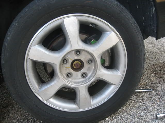

and last but not least, it fit behind the wheel just fine.

Yep, turns out my rotors are more fukked than I thought. I put the mic to them and they only specced out at 27.6 mm and the minimum is 26mm so I decided to just replace them, got a new set from O'reilys. Pics tomorrow.
rotors
Postby NRDriver » Fri Feb 13, 2009 11:49 pm
i was about to say you should atleast machine them if you dont feel like eating up your new pads
