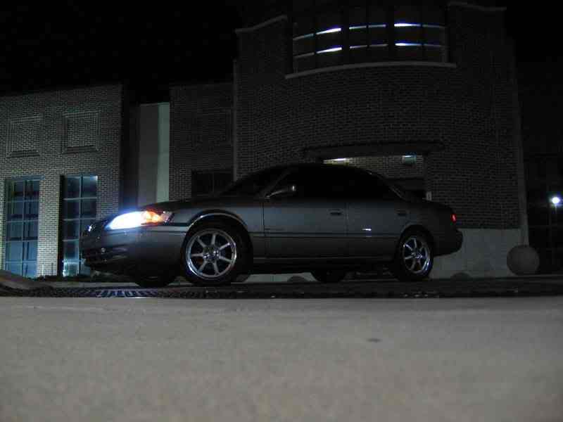

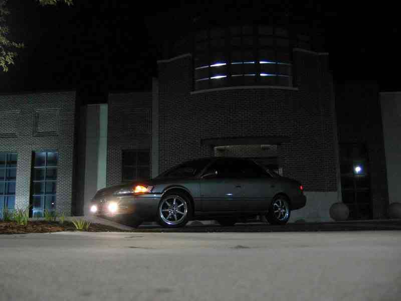

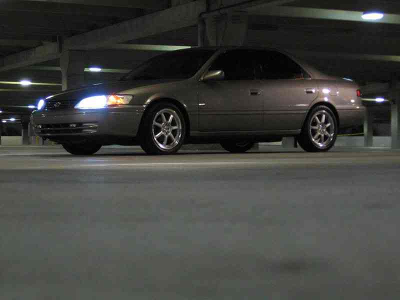

yeah i agree about researching it too. also i have an 8000K setup on my car no high beams just a single beam H3 kit. I have NEVER needed the highs with the HID's installed. I don't have projectors any my lights look awesome. The thing I would suggest is to do a 3000K foglight buld with the 8000K HID headlights. Stick to buying 1 set for your low beams and do a nicer halogen for your highs getting the high beams will be a waste of your money. As for the heat issue. The bulbs are cooler like NeFaRiOuS_SLE said and the ballasts do get hot but if properly installed neither should cause any problems. And by the way this was the best thing I did to my car. Once you get HIDs you'll never go back to halogen.Image
