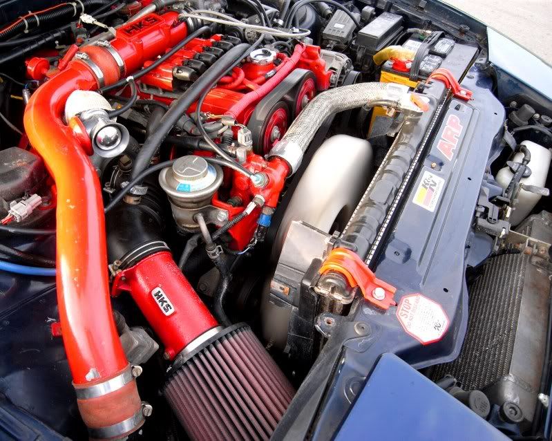

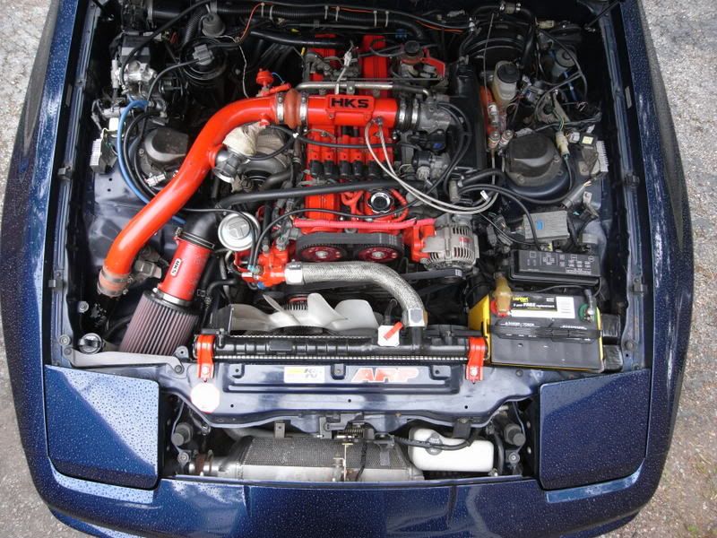

Postby crispone » Wed Jun 27, 2007 8:46 pm
^^^ I liked it SO MUCH, I put one in my SUPRA!!!
(WORKS GREAT!) The one in the 'lara STILL doesn't show any signs of "drying out", which is why I swapped out the afe... AND... it doesn't "BUZZ" (as noted before) nor WHINE/RAZZ as "nasal" as the afe did with the CP-e at full honk. I'm pleased with my look, function, and what appears to be... performance.
G/L to anyone else in their experiements... and happy if it worked out for those who tried it! :wink:
