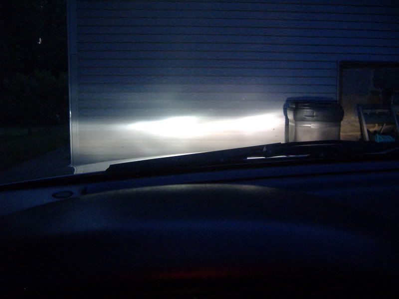

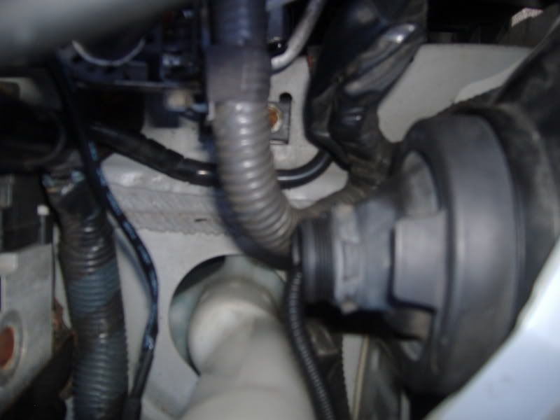

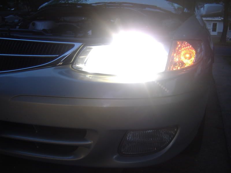

install was interesting but it turned out good. Two small problems though.. bulbs dont seem to match in color! i know you have to let them burn in first but after how many hours of use should i expect them to match? another thing, the rubber ring behind the bulbs arent perfectly sealed. the bulbs were too big for the rubber to cover (look at picture #3)..any suggestions about that would be appreciated....but aside that, i love them! check out some of the footage
