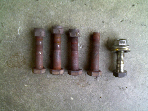

YES THANK YOU! .....helped alot when the auto parts helped none. I'm getting everything installed on Saturday. Only thing left is the bolts/nuts.
I told my brother I was going to buy bolts from the hardware store, and he warned me against it. He said the bolts are of different grade. That the heat will cause hardware store bolts to become brittle with time and snap. Has anyone ever heard of this?
Is there a certain length/girth/type/combo? Do I need washers?
Sorry for all the questions, I like to be precise. :D
LatinDragonXJC
Posts: 1064
Postby Midias » Wed Aug 20, 2008 8:59 pm
I usually get m10 x 1.25 x 30 or 35mm automotive stainless bolts form autozone or who ever. I have never had a need for washers.

Postby CamryOnBronze » Thu Aug 21, 2008 6:15 am
just dont use nuts with nylon centers because the heat will melt them. Otherwise, I think youll be fine.
