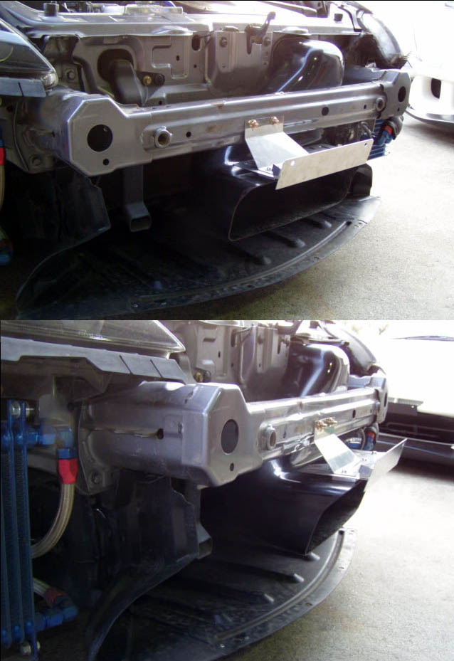

What I'm looking for is an intake that has a remote tube ending outside the engine bay in front of the bodywork (grill, under bumper, etc.). The better ones will have a water trap to prevent rain and road dirt from reaching the filter.

Postby PhreakdOut » Sun Aug 10, 2008 6:20 am
Tacti built his own CAI. The battery is in the way. If you mount it 90 from current position or relocate it into the trunk, then you have access to run the tubing down behind the driver's side headlight and mount the filter behind the driver's side fog light. (Lots of air there.)
If you wanted to get clever, remove the fogs and make a ram air setup. (A bit of work.)
I'd like to see someone make a box where the battery is and adapt it to use a flat K&N filter. Run a ram air from the fog light hole and up into the box. The air would be cooler than the engine bay's and filter cleaning would be easier. You may be able to modify a standard polished aluminum battery box and mount it in the current battery position. (Then you just need to add hole, mount tubes and adapt a filter to fit the box.)

It's tough to design a ram-air setup for the Gen V6, but a CAI setup could be done but not without a lot of work and you'd still have to move the battery in any case.
There are no 2-hr shortcuts to that project.

One of the cleanest air intake designs I have seen is the RX8 REVi. Bigger K&N round filter with "horn" towards MAF, inside a closed box for cooler air intake. There is also a RamAirDuct.
In the RX8 case, they can make a cold air extension and put the filter directly in front of radiator: Image.
Scoop anybody?
