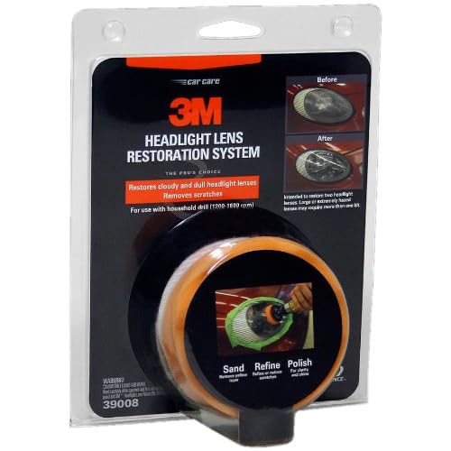

I had this happen as well. I bought a kit by 3M headlight lens restoration kit pictured below...
I was very happy with the results. I only used the 3M trizact disc and the 3M polish compound with the buffing pad. Mine were not hazed enough to used the sanding and finishing pads. The product worked very good and it has been about 2 weeks since I used this product and they haven't showed any signs of rehazing yet. I am hoping this was a permanent solution but time will tell. If they rehaze I will be replacing with new housings.
Replacing a headlight just require you to remove the front bumper (held on by just a few screws). Seems intimidating, but it is actually a very easy process.

Anyone else tried the 3M kit above? i tried the PlaticX thing with sand paper but the hazing comes back within 2-3 months.
i am wondering if the 3M kit is a more permanent solution
1999, 5 Speed V6
mazen222
Posts: 698
Re: Headlamp Glazing
Postby SoSleek » Fri Jun 04, 2010 9:18 am
As mentioned, I used it. I only used the trizact pad (which i believe is similar to 3000grit) and the polish and polishing pad. So far so good. That was about 5 or 6 weeks ago. I read several reviews online of people with serious glazing or yellowing and they all loved the product.
