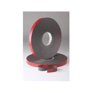

PS: I should note that the reason for the ballast getting thrashed is because of the one product they used that was not of top QUALITY...The mounting tape. I will recommend that you use NO other mounting tape than 3M's VHB tape...which stands for Very High Bond. This is the strongest mounting tape 3M makes and it outperform any mounting tape out there. Use Acetone, or isopropyl alcohol, to prep all mounting surfaces. Picture below...

^ I agree with you. My DDM Tuning HID kit came with cheap double sided tape. As soon as the engine got hot the ballast just slid off the mounting surface. I got some 3M tape just like you and it hasn't moved since.
