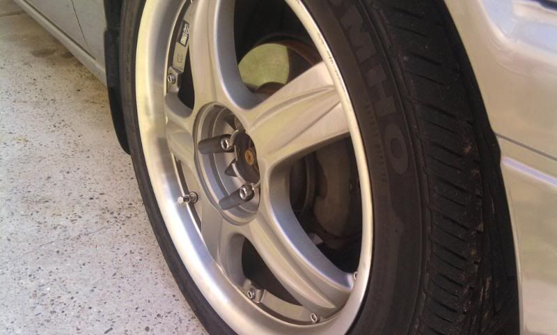

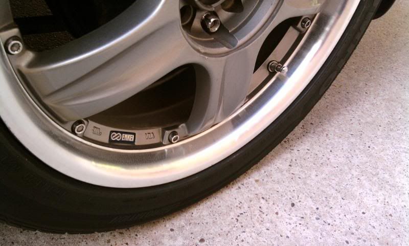

well ive had my wheels for 4 years now and they were definitely starting to show their age mainly the lips. so i decided to rip of the clear and sand and polish them up. people weren't kidding that this stuff is time consuming. only got one wheel done now so i thought id show a comparison
before clear was takin off
after clear was taken off
after sanding and polishing
kinda hard to see the differences unless you saw it in person. ill get more pictures as i continue. im also going to polish up my stock muffler since ive never seen it done on a camry.

Postby Camman » Fri Apr 09, 2010 10:18 pm
yeah its not bad for my first time
only used 1000 and 1500 grit

Postby 209solara209 » Fri Apr 09, 2010 11:22 pm
i like it.
How did you remove the clear?

Postby Camman » Mon Apr 12, 2010 6:45 pm
to get the clear off i used airplane paint remover
its very strong. i just applied it with a brush and the clear just crinkled up and came off
you can find it at a autoparts store
