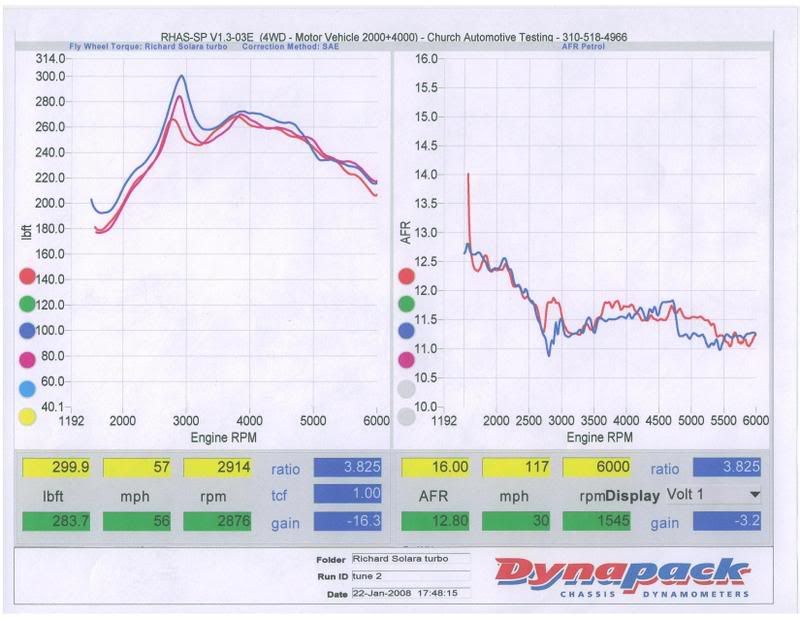

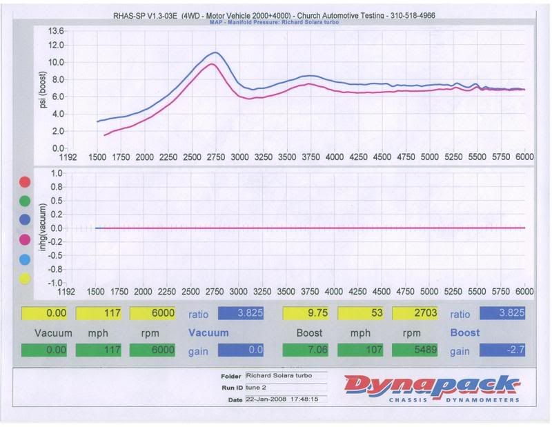

:( sad i didn't get much hp as i wanted but i found out why.
i need to adjust the wastegate cause at 3000-6000 rpm the boost levels drop to 6.5 psi.
time for a boost controller and couple little other things.
Hey guys here are the dyno numbers and a little video of my car on the dyno.

goddamn! i love it when theres more torque and hp! Can't wait to see the torque curve when the dyno gets posted

i got that max tq a little under 3000 rpm and after that i started loosing boost for some reason and remain at 260 tq almost the whole way through

i was hoping to get maybe 260 - 270 hp but i think i well probably hit that after i get the wastegate problem fix. but i haven't really changed anything on the car since i had it. beside upgrading to bigger injectors and 3" down pipe all the way through.

That is a lot of torque for a 2.4L motor, very nice.
