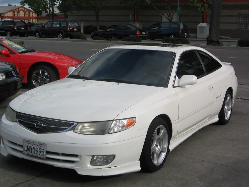

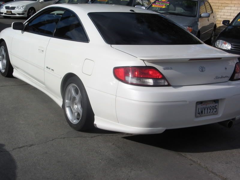

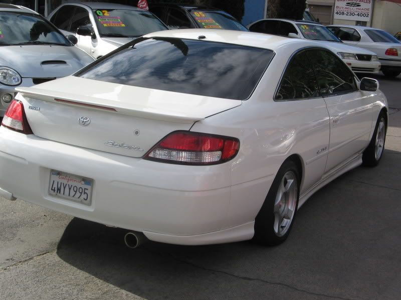

Postby Toy1mzfe » Tue May 05, 2009 7:09 pm
So i was craigslisting solara and this is what i found.
I dont think it looks too shabby. I would paint them i use them but whatevers.
Here are pictures that shows that they fit for anyone looking for cheap upgrade of wheels that are wider and better offsetted.
Postby GreeKAvaLoN » Tue May 05, 2009 8:42 pm
wow the solara emblem on the bottom corner of the trunk looks odd to me. (yay for the white av in the background! lol) find some blank center caps and fix the front lip and it wouldnt be too bad..

Postby Ilovemylara » Wed May 06, 2009 2:56 am
The lip kit is most likely cheap fiberglass, as its missing the rear center piece that a authentic kazuma kit comes with, but the wheels look pretty good though. I didnt know that ford and toyota had the same lugnut pattern. ???

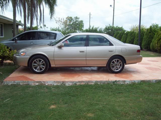

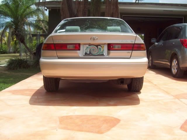

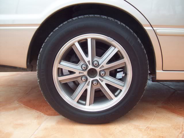

Postby GTX » Fri May 08, 2009 3:32 pm
My Camry has Mustang wheels on it. They were from an '05 V6, a friend gave them to me for free. I needed new tires anyway and the bolt pattern + offset are the same (S197 Mustangs have FWD-like offsets for some reason). The only hard part was finding hub rings for them since Mustangs have 70.5mm hubs and the size I needed was extremely uncommon.
I think they'll look better with new lug nuts and some center caps.
