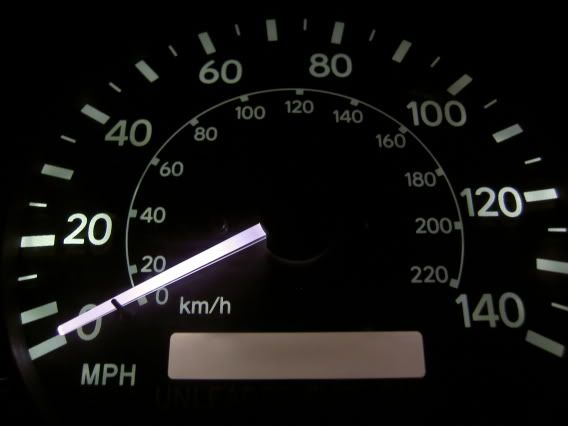

Postby DrLove » Sat Mar 01, 2008 7:15 pm
I found that CASTRO did the same on a camry cluster.
But the camry gauges have transparent needles, not red/orange like Solara. It looks even better.
look:
And this is my Solara:

hmm...I installed the white 5-led wedge type from superbrightleds in my gauge cluster and it looks very dim, and not super white. Where did you stick the reflective tape to? It seems to be blocking more light than it reflects...maybe I have the wrong tape?
I'm pretty new to the gauge lighting, so any help is appreciated.

the needles are fine, its the actual gauges themselves that are dim...jeff are you sure these are the bulbs you used?

My gauges are white and my auto hvac is white aswell. The reason the gauges arent bright is there is a light green tint over them. Certain colors like red and blue show through no problem but white seems to have a hint of green in it. As for the hvac, it has no tint making it very white...

^^exactly, its like a dim green color. Any way to combat this? I know guys ou there have very nice white gauges, I just need to find a way to get there. In the meanwhile, my dash is spread all over the garage and the wife is getting very impatient. :)

I don't have "little green" color with my white LED gauges, I would say that it's a bit "white-gray" and you canot get a perfect white, it's not an "optitron" gauges like the new toyota & lexus. I also "dim" mine or they are too bright at night. I use 1W white LED. It makes little "hotspot" but it's 1000 times better then the green color..when I remember how ugly it was compare to now,I cant go back to stock with the gauges hehe. My HVAC are pretty bright, I used a white led strip.the result is great!... But for sure red or blue LED would be more easy for the color match.
