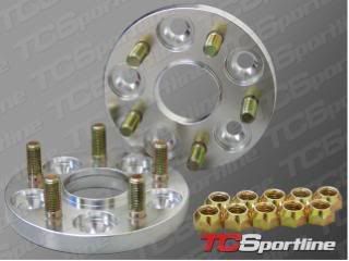

Postby rollaevo99 » Wed Oct 11, 2006 1:41 pm
^^^that's not bad....I can tell the difference.....I was thinking about doing the same thing....... using adaptor instead.......like this one.

Okay - so why would someone go with a "Wheel Adapter" vs a spacer?
I could see if you're changing bolt patterns/spacing sizes...
Do they even make those? (going from 5x114.3 to 5x120)
If so - I would LOVE to score some 18" BMW rims!! :D
EDIT: I answered my own question - Duh!
H&R: http://www.srbpower.com/hr/spacers.php

Postby Sentinel » Thu Oct 12, 2006 9:17 am
It would seem that an adaptor could be safer (properly made)
While adding more unsprung weight than a spacer, you ensure you have full thread engagement.
Any spacer reduces your thread engagement by that much.
