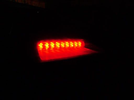

biggie: its pretty easy. all you need is a little soldering skill... cause it didnt come with any wires attached.
so, all you really need to do is solder 2 wires. one positive and one negitive onto the ends of the LED strip.
here we go:
take out your panel that covers your back speakers. (i think most of you guys know how to get back there). remove the red plastic piece from the clps. cut off the old bulb harness. then i used some electrical tape to kinda hold the LED strip in place (in the middle) against he red plastic piece. cut off extra electrical tape. use some wire connectors to connect the wires. make sure you find out which wire is positive or negitive. get a 9 volt battery and do a quck test before you install. then just pop the red plastic piece and LED strip back into the clips. the LED strip should be pretty snug against the red srtip. then reinstall everything back.
i'll try toget some pics up later.
peace out!

Postby Biggi_e » Thu Jun 21, 2007 4:25 pm
sweet thanks Van, pics would def. help tho!
