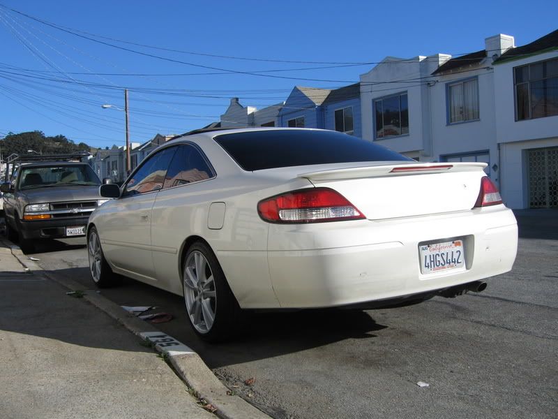

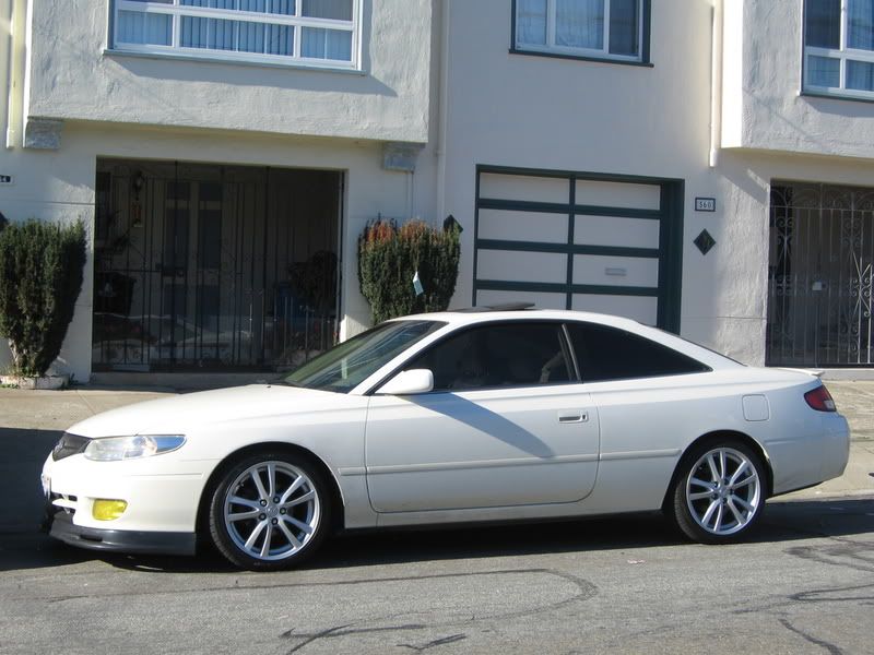

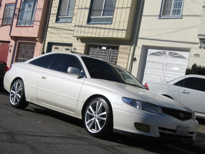

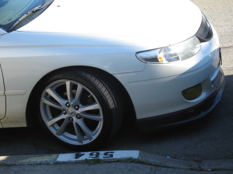

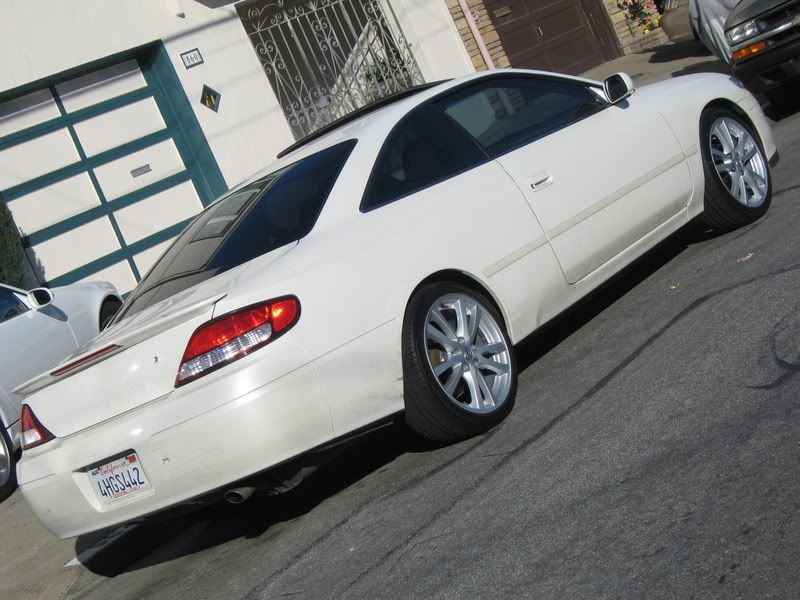

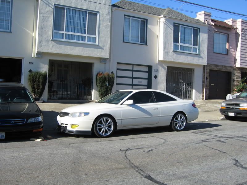

So here it is. the past month have been hell. Dealing with my wheel problem. I hit a pot hole and dented my 19's. Took it to several places and none could fix it. Then during that time, i got rear ended. Me and the girl have been going to Chiro. Dealin with insurance STILL.
I bought the is350 wheels 2 weeks before the pot hole, and was planned to be invested and resold. but the pothole made me no choice but to run those on my car.
specs once again:
Front:
is350 Front 18x8
offset: 45
Tires: Falken fk912 225-40-18 (brand new)
Spacers: NONE
Rear:
is350 Rear 18x8.5
offset: 50
Tires: Kuhmo kh11 225-40-18 (7/10" used)
Spacers: ichaba 15mm
TOTAL OFFSET: 35
Fender Mod: Shave.
Where: Rears
The wheels are too big for plug and play. The 35 offset and 225-40-18 on teins stechs, require you to shave or roll your fender. I went to sears bought a grinder and cut that 8itch off. after grinding it 4 times, i got it right.
For those who are trying this setup, shave it right the first time, just cut more. And dont forget to paint to prevent rust.
225-40-18 is the best tire size for this setup (18x8.5).
The Wheel is very very close to the shock, but clears the shock. so this is the max you can go on your car with shaved or rolled fenders... unless u pull your fenders or make them wider.
Is350wheels: 350
Spacers: 60
tires: 300
tire install: 55
stock lugs 30
install spacers 70
grinder 30
_________________
= 840
worth it? You be the judge.

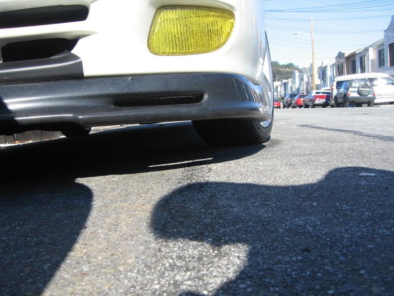

A lil something something.
Lip= Like it or not?

thumbs up for the lip
how the heck did u get tires for that cheap?

Postby kingkakyle » Mon Dec 10, 2007 2:45 am
looks good i like
lip kit is kind of ehhh....just seems like its on there...looks kind of green too haha
i spent almost as much as u just on tires alone!!! lol probably more if u include tax.....
Postby 94CoupeV6 » Mon Dec 10, 2007 3:35 am
Those wheels look great on your Solara.

Postby Down2TheC » Mon Dec 10, 2007 6:14 am
Worth it. Nice slicing on that rear fender. I noticed in the stealership that the Gen2.5's have the rear pretty much prerolled like the front.

Postby Akfahad » Mon Dec 10, 2007 6:39 am
like the lip = keep it!
Postby trdkamuri51o » Mon Dec 10, 2007 8:25 am
i know that lip from somewhere i just dont knwo where.. aha

Postby prsolara » Mon Dec 10, 2007 10:02 am
like those wheels looks really great on the car...
for the lip, the car looks better without it....

Postby akora12 » Mon Dec 10, 2007 10:10 am
The wheels look hot. I love factory swaps.

Postby Toy1mzfe » Tue Dec 11, 2007 10:16 am
thanksd for the comments

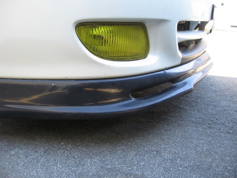

the The lip is acvcyally screwed on to my hD lip that i made.
it is lower but the lip looks kinda not too great right now because there are no side skirts on it
with the grill. ikinda like it like that. the reniva would be nice but im low on funds.

Postby Solarizona » Wed Dec 12, 2007 2:52 pm
Very nice! I originally wanted to use those same wheels. Looks great.
