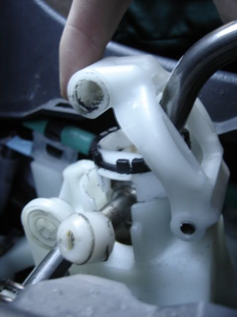

The short shifter didn't come with instructions, and I've made it this far by going off old posts here and the guide on twm's site, which says its for a solara/camry, but the pics are from a corolla, and the setup is a bit different.
I've almost got the stock shifter out of place, I got the two bottom clips and the pin on top out. But now there is a 'cap' (circled in red) which is hinged (circled in yellow), and I cant see where to go from here. Can anyone let me know what the next step is? Do I have to remove that hinge somehow? The second pic shows how far I can move the shifter.

Postby QuickSEV6 » Fri Mar 09, 2007 1:09 pm
Its been a couple of months since I installed mine, but I'll try to help out as best I can.
Yes, that pin circled in Yellow must be removed. I used a small screwdriver (or a punch) and a small hammer to knock it out of place. Its not secured, so once you get it started, it should just slide out.
Good luck!
Postby Fresco Bob » Fri Mar 09, 2007 1:12 pm
ok thanks, you described what to do pretty well in an old post and I finally figured out what you were talking about. Looks like its gonna be a beotch, did you remove the console?

Postby QuickSEV6 » Fri Mar 09, 2007 1:16 pm
Fresco Bob wrote:ok thanks, you described what to do pretty well in an old post and I finally figured out what you were talking about. Looks like its gonna be a beotch
The most difficult part, for me anyway, was putting the other pin in and locking it with that clip. I had to use a 12mm socket and a very large set of Channel locks to squeeze the lock into place. The whole thing took me about 1.5 hours to do.
Once done though, you'll see it was worth the effort.
Enjoy!
Postby Fresco Bob » Fri Mar 09, 2007 2:50 pm
Anybody have this probly with the second pin on the bottom (mounts to the very bottom of the shifter) When I took it off the 'legs' of the pin were tight against the plastic part, and now they are off to the side, kind of bow-legged. Any ideas? The red lines show how they should be.

Postby Fresco Bob » Fri Mar 09, 2007 3:21 pm
hmm nevermind, they it seems to have worked its way back into place

Postby funboy102 » Fri Mar 09, 2007 3:58 pm
damnnnn, I got the same exact problem as you. I had that TWM SS laying around my trunk for like 3 months already. I try like every other week to remove that tiny pin, but I just can't do it. Did you finally get it out Fresco bob? How did YOU do it? I tried poking it out with a tiny screwdriver, but that didn't work. I tried a pin and hammer, but that didn't work also. Anyone in SoCal can help me on just this ONE part? Pleaseeee????

Postby Fresco Bob » Fri Mar 09, 2007 7:18 pm
ya, I got it started by hammering on one end with a screw driver, then once there was enough sticking out the other end I clamped onto it with a set of channel locks. Once you get a good grip with the channel locks, use a hammer on the channel locks to get the pin out. Once it moves 1\4inch or so get a new grip with the channel locks and hammer away again. Reverse that for putting it back in.
