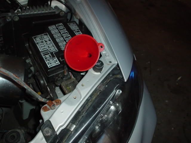

Postby iinokturnolii » Mon Mar 26, 2007 3:37 pm
woa_its_j3ff wrote:aight im not in a fu_king mood to be played around with today. either you give some useful advice or shut the f_ck up.
wiring and everything on my lighting is fine.
where can i find this blinker fluid?
be easy...
pick up blinker fluid @ local Autozone
and then add fluid here:
iinokturnolii
Exotic Herb Sampler
Exotic Herb Sampler
Posts: 952
Location: OAKLAND, California
