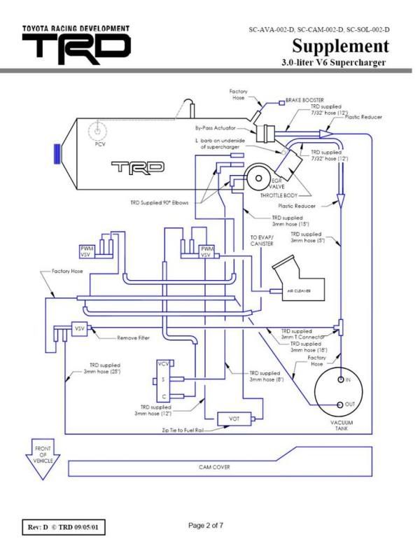

Postby charged ninja » Sun Jan 21, 2007 5:09 pm
just put new motor in NO boost I know I have vacuum line wrong but dont know what ones

Postby siennasc98 » Sun Jan 21, 2007 6:01 pm
charged ninja wrote:just put new motor in NO boost I know I have vacuum line wrong but dont know what ones
If you need the diagram:

Postby DatSRBoi » Sun Jan 21, 2007 6:01 pm
charged ninja wrote:if I keep the motor under 3000 rpms its is ok. But if I get on it the vacuum gauge goes up to 0 than slams back down and the car starts bucking
I dont get what your trying to say. Did you wire it according to the wire diagram or did you do everything off hopes. If you didnt wire it with a diagram from TRD then Ill find it later and reup.

Postby JavaJoe_2 » Sun Jan 21, 2007 10:02 pm
Or try these TRD Diagrams
