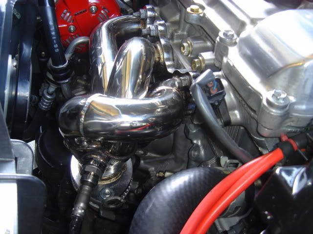

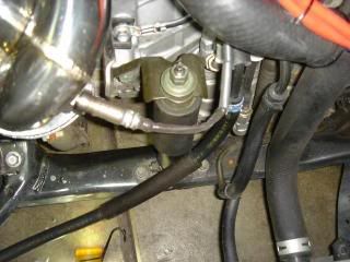

"Mole" is correct. A second O2 sensor is needed for the rear bank. The rear header (small) flange is for the EGR tube. My sienna doesn't have or need an EGR so I used the (vacated) space for the rear 02 sensor bung.
I bought the same set just to try them. I installed the headers for now. Will take the van to my local muffler shop to custom install the Y-pipe after a few weeks of using just the headers. On my Sienna, the OEM Y-pipe comes with catalytic converter (assembled together/1-piece).
Image Image
Aside from adding a 2nd 02 sensor bung, you need to cut one of the exhaust (right) bolt. Also, the front 02 sensor bung is in the wrong orientation, it's more on the radiator/fan shroud side. You have to relocate the engine wiring harness (02/Cam position sensor) connector so the 02 sensor cable will reach.
Image Image
Image Image
After a few test runs, I don't think the power gain is significant or noticeable on my S/C'd engine. They looks good though.

Postby siennasc98 » Tue Feb 13, 2007 9:38 pm
After 3-days, the stainless headers turned into a shade of gold (or bronze) after they are subjected to exhaust heat.

Postby Midias » Wed Feb 14, 2007 5:18 am
ThatVietGuy wrote:That can't be good :lol:
ALL single wall SS headers and pipes do that it is common
That is why Honda uses double wall pipes on their motorcycles.
