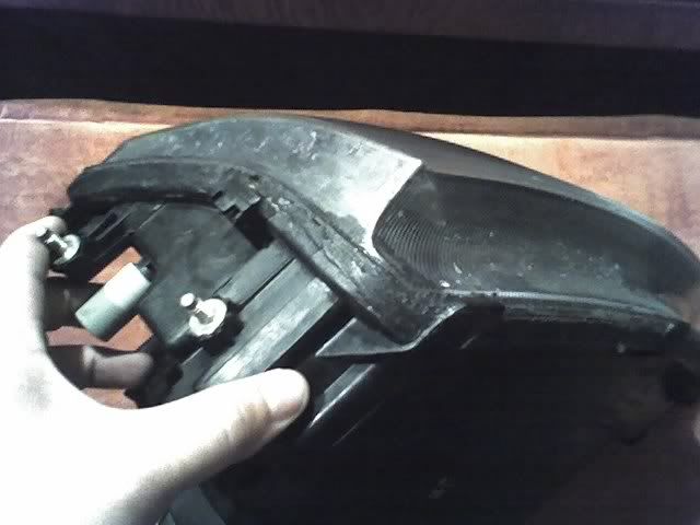

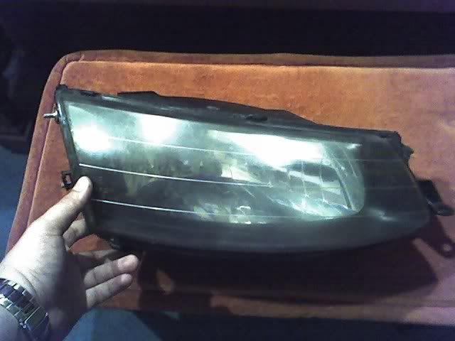

Postby Got2XLR8 NYX » Fri Apr 27, 2007 10:21 pm
Heres some pics that I just took on my phone so pardon the quality...
This is the pic of the final product, the lens looks cloudy and it is but thats because its really pitted and not from moisture.
This is a pic of only a part of the reseal just to show how it pays of to throughly remove all and i mean all of the original Sealer. I recommend that after u take the light out of the oven, to take a flathead screwdriver and run it all the way around the groove where the sealer is. You do it when u take it out of the oven b/c that is when the sealant is still hot and gooey or else when it cools it gets tough.
This last pic is from behind the headlight... What i circled is the vents that are there to let the moisture out of the headlight. When and if u open it there might be sum old dried out foam and thats why i just replaced it with sum cotton... all this done around this time last year. I hope this helps and if u need better resolution shots just lemme know and i'll get them for ya.
