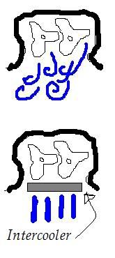

yes the gain will differ with boost setting
where 4 psi - the intercooler could net you about 8hp, the intercooler could net you more like 40 or 50hp at 30psi+
the chemistry still doesnt add up in my opinion though, subtract 10-15hp from increased rotating assembly strain, and add maybe 20-25hp from the cooling effect
this is not a large front mount guys, its a big meshed up chunk that bottle necks up the already tiny supercharger volume.
the only thing i like about it, is that the boost isnt going to be all swirly going into your heads from the screws
kinda like this
