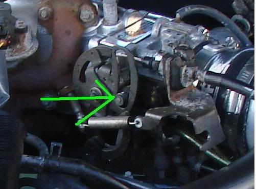

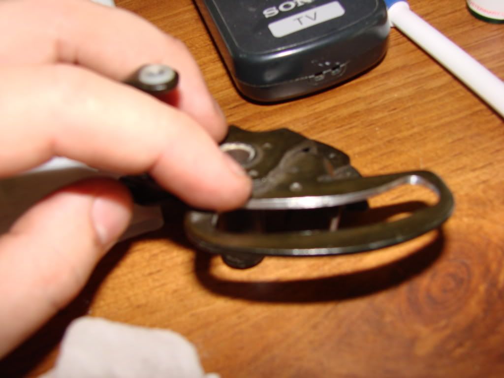

Midias wrote:OK I got the idle fixed part of the throttle rotor was keeping the plate open a little and thus making a high idle. It is not perfect now about 900 but I will see what it does. To fix it I had to grind the rotor a bit with my dremel here are some pics. I removed a little material where the green arrow and my finger are. I was worried about making the gap too big but upon inspection the original I noticed it does not touch at idle.
******EDIT******
Computer has kicked in and Idle is perfect
