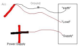

I have very little electrical knowledge. Practically none.
Heres what I have: The wire(s) coming from my accessory (With Power and Ground Wire) and a switch that lights up with three prongs (Earth, Load, Supply) and A Power supply.
Correct me if I'm wrong and help out please:
I want to put the Acc ground wire to a ground, and the power to the Load Prong in the switch?
The Earth prong should be grounded to a ground, correct?
And the prong for Supply should go to a source of power (ie Fuse or Battery)
I'm not really clear on the terms "supply" and "load" as labeled on the switch, or what gets wired to what
Here's what I THINK is correct. Somone help!

Postby SleeperSolara » Wed Feb 08, 2006 7:50 pm
That correct.

Postby indiglosolara » Thu Feb 09, 2006 12:04 am
I drew a quick diagram of how i would do it. I used Battery as power source but you can also use your igntion constant 12volt if you have already located one.
I would ground your switch and accessories seperately, doesn't matter how much power it takes. I would do it just to be on the safe side. I have a smiliar set-up as what your looking for. Also use a inline fuse with a 10amp or 5amp if its a small item with low wattage.
Hope this diagram helps a little bit.

Postby SleeperSolara » Thu Feb 09, 2006 8:03 am
Also to make it easier us female connecters to connect the wires to the switch.
Postby FLASH » Thu Feb 09, 2006 8:49 am
Thanks a million guys. This is exactly what I needed. I appreciate it!
