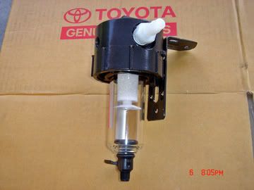

I did this mod today. I used the Craftsman Air Line Filter ( 9 16008).
They only have one in stock, so I did the (Bank 2) breather to intake for now. I mounted the filter on the battery plastic shield.

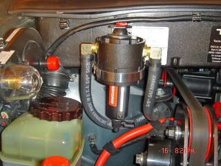

Today, I installed the catcher for the other side (from the PCV to the Supercharger intake barb. I used a different bracket this time, just a piece water pipe coupler.
Will see how much oil is trapped in two weeks when we take a trip to Lake Tahoe.

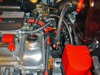

I have two oil catchers. Yes, the catcher for the PCV to the supercharger is a little bit farther so I moved it and it's now located here. The catch bottle was upgraded to metal (bowl, P/N 4203-50RF);
After about 500 miles, here is the quantity of trapped oil on the catcher for the breather (Bank 2 side) to the intake hose.
Now that the catch bowl is made of metal, the kit is now mounted on the valve cover.
