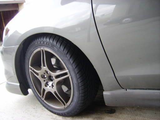

Postby Toy1mzfe » Fri Sep 04, 2009 1:12 am
I dont know if they are worth getting powder coated. Cause getting them done may cost a pretty penny. But with that pretty penny to can get some other wheels.
I say just DIY Rattle can it.
This is the bronze i did on my last car with Kragen duplicolor bronze.
http://img.photobucket.com/albums/v490/ ... G_1835.jpg
http://img.photobucket.com/albums/v490/ ... 706021.jpg

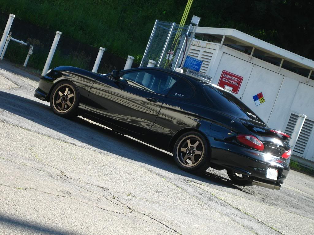

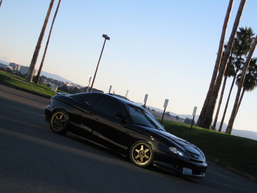

Postby Projex0 » Fri Sep 04, 2009 1:39 am
^ how long did that take you to do and how many coats? any clear coat on it?
(pictures from rohand)
if black looks this good bronze might not be so bad, but what shade of bronze do you want.
ex. powder coated mineral bronze
he got it done for $150 each at Island's Powder Coating at 1322 Sta Anita Ave in South El Monte

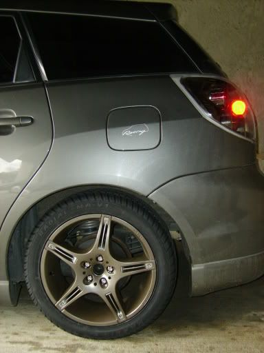

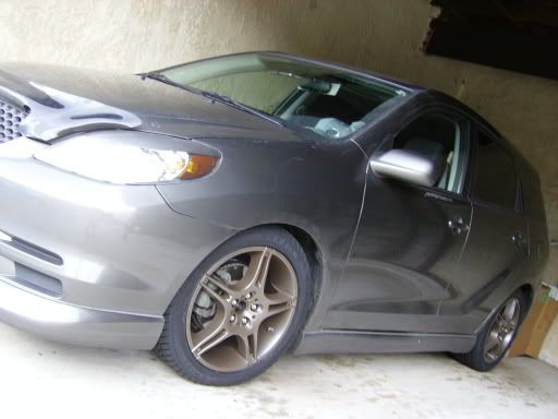

Well just make sure your home for a day.
NEED: Sand paper, news paper, tape, degreaser. Duplicolor: Adhesive Promoter, Wheel Paint, Clear.
-First you degrease the wheel.
-Then you sand the wheel down, you wanna rough it up so that the paint can stick.
-Then you clean down the sanded area with a wet cloth and let it dry.
-cover the areas you dont want to paint.
-3 coats of adhesive promoter. with 5 minutes between coats.
-3-4 coats of color. start out lightly, dont worry if its not covering all areas the first couple coats. So first and second coat is light, then get heavier 3-4 and maybe 5 if needed. 20minutes between each coat.
- Spray 3-4 coats of Clear coat. Once again start light then get heavy. with 15minutes in between each coat. The more coats, the shinier and clean the finish.
Let it sit overnight or so and it should be good.
(i didnt wet sand. not really sure how to do it. but you guys can if u want.)
This is the pictures of what i did. This was the first time i did it.
http://www.rdtiburon.com/index.php?show ... &hl=bronze
Silver didnt really do it for me so i did the bronze. much better!
And this is the finish product of the bronze.
Postby ToyoSolV6 » Fri Sep 04, 2009 10:47 am
^kevin that tiburon looked good with those bronze!, i would still like to see my car photoshopped just to see the look :), but like i said im debating
